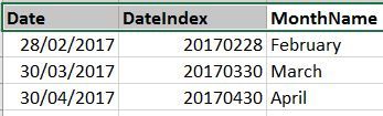

Hi @FrugalEconomist,
I tried doing the same but using Excel. I have a date field, I added columns yyyymmdd and month name.
In Power BI Data view, I selected MonthName column and clicked on 'SortByColumn' option and selected DateIndex. The month was sorted correctly.
I have a before screenshot for comparison.
I think this is similar to having the DateIndex column in SQL.
If you could post your date, dateindex and month name fields may be that could shed some light.
