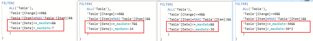

Hi, @vpsoini
@ERD has provided a solution, and I came up with another solution that I hope will help as well.
I offer another solution for your reference, which does not require you to have a separate date table.
last 7 days:
last 7 days =
var _maxDate=CALCULATE(MAX('Table'[Date]),ALL('Table'))
var _sum=
CALCULATE(
SUM('Table'[Change]),
FILTER(
ALL('Table'),
'Table'[Change]<=0&&
'Table'[Item]=MAX('Table'[Item])&&
'Table'[Date]<=_maxDate&&
'Table'[Date]>_maxDate-7
var _abs=ABS(_sum)
return _abs
to change the _maxDate-N to get other measures:
last 7(30) days, previous 7(30)days:
cons. change:
CMP_30days = DIVIDE([last 30 days]-[previous 30days],[previous 30days])
Result:
Please refer to the attachment below for details. Hope this helps.
