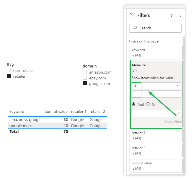

According to your description, I think you can create a measure, then use it in the filter pane.
Like this:
Measure =
VAR a =
    MAX ( Metrics[retailer 2] )
VAR b =
    MAX ( Flag[retailer 1] )
    IF ( a = b || b = BLANK (), 1, 0 )
Here is my sample .pbix file. I hope it helps.
If you do not solve your problem, please feel free to ask me.
Best regards
Janey Guo
