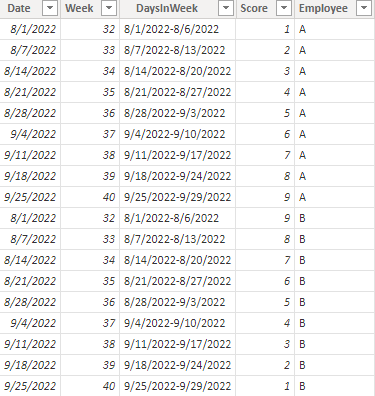

I would like to know how to show those employees that have score below target value (ex. 2.75).
1. 3 consecutive weeks below 2.75
2. 4 consecutive weeks below 2.75
2. 4 consecutive weeks below 2.75 in the last 6 weeks
Should be based on the slicer value also (number of last nth weeks).
please advise amitchandak Greg_Deckler Anonymous

  • Hi nftgamesendaya ,
    According to your description, I create a sample.
    Here's my solution.
    Create a measure.
    3 consecutive =
    VAR _MAX =
        MAXX ( ALL ( 'Table' ), 'Table'[Week] )
        IF (
            SUMX (
                FILTER (
                    ALL ( 'Table' ),
                    'Table'[Week] = _MAX
                        && 'Table'[Employee] = MAX ( 'Table'[Employee] )
                'Table'[Score]
            ) < [Target]
                && SUMX (
                    FILTER (
                        ALL ( 'Table' ),
                        'Table'[Week] = _MAX - 1
                    'Table'[Score]
                ) < [Target]
                && SUMX (
                    FILTER (
                        ALL ( 'Table' ),
                        'Table'[Week] = _MAX - 2
                    'Table'[Score]
                ) < [Target],
            1
    Get the result.

      hi v-yanjiang-msft , appreciate the time you alloted on this inquiry. I'm not sure though what does the 3 consecutive column do? What I want to know is to identify which employee has a.) 3 consecutive weeks with below target score (ex. 2.75). Also not sure what is the value you've set for [TARGET]. Please advise. Thank you.
      • v-yanjiang-msft's avatar
        v-yanjiang-msft
        Hi nftgamesendaya ,
        I just want to show which employee has reached the limit. Certainly you can change it to yes or no
        Target is a measure to show the certain value like 2.75 in your example.
        You can alse download my pbix. file I attached below to see more details.
