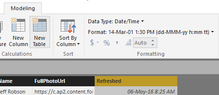

I picked one of my small lookup tables and added a custom column using Query.
Refreshed  = DateTime.LocalNow()
I then formatted that new column to remove seconds and put the Month letters in rather than 05
I then used that column in a Card visualisation - all done.  No need for a measure.

Hi Electrobit
If you drag a date field into a card you will get a count of date
You will need to create a measure to drag into a card, such as =Max(Sales[Date])
Dragging that measure into a card will show the latest sales date in that Card

Thank you, your approach still worked. After I did the custom column "last refresh1". I added a measure
Last Refresh = Max (Table{last refresh1}) and that worked!
