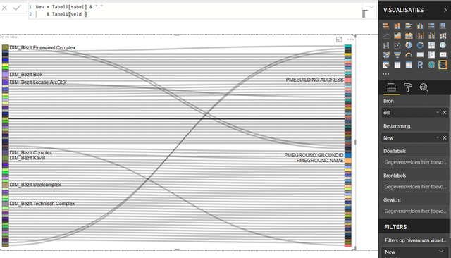

@Anonymous,
You may try adding calculated columns.
Column =
Table1[new table] & "."
& Table1[new column name]
Column 2 =
Table1[old table] & "."
& Table1[old column name]
Just use this approach
https://www.youtube.com/watch?v=K9uQD561F6Q
It's really work.
