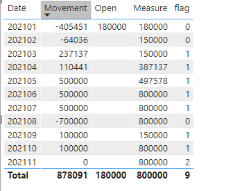

I think all is ok now but 202109 as it should be 300000-100000=200000 but it shows 700000
am I missing something?

I amended 210107 to -700000
pls note 210109 - should be 150'000 - 100000-100000 <150000 --> 150000
also 210110 is not correct

Sorry,I dont think there is a suitable measure to fit different values based on such criteria,as the result has always been checked.Even I give a measure for this set of movements,it may return errors in another set of movements,as the results will be reset for many times,which cant be determined.
