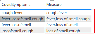

If your .pbix is  "Direct Query mode" , you should use dax (create a measure )as follows:
Measure = var _replace=SUBSTITUTE(MAX([CovidSymptoms])," ",",")
return SUBSTITUTE(_replace,"lossofsmel","loss of smel")
he final output is shown below:
Community Support Team_ Yalan Wu

Hi, @TaufikMaggangka ;
You could change measure as follows:
Measure = var _a=SUBSTITUTE(MAX([CovidSymptoms])," ",",")
var _b=SUBSTITUTE(_a,"lossofsmel","loss of smel")
var _c=SUBSTITUTE(_b,"fever","Fever")
return SUBSTITUTE(_c,"cough","Cough")
Thank you so much. this is a sollution.
