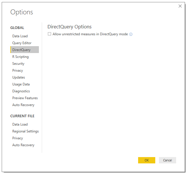

    If you have a solution with CALCULATE
    File | Options and settings | Options | DirectQuery -> Allow unresticted measures

      I just turned that option on. However the "solutions" I found were not exactally what I wanted. Still trying to wrap my head around how this DAX stuff works. Any pointers on how to generate a formula to calculate these user counts would be a big help.
