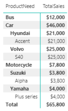

When I create a matrix value, I get the below table with blank rows being displayed in the product type and Product family for Bus Product need category
I want to display the all categories and restrict the blank row display for Product Type and Product Family and still be able to show the complete total value. If I apply filter to remove the blank from Product Type or Product family, it removes bus option completely from Product Need and the total value is also reduced. Any idea how I can limit the blank row in subsequent cateogirs without affecting total value or display on the matrix?

MarkLaf
One technique I use in situations like this is the following:
  1. Calculate the hierarchy depth for each row in your table (i.e. calculated column)
    note this assumes the blank cells are actually blank/null and not empty text ("") - if they are empty text, either make null in PowerQuery or use a different check ( e.g. LEN([column])>0 😞
    HierarchyDepth =
    ISTEXT([ProductNeed])
    +ISTEXT([ProductType])
    +ISTEXT([ProductFamily])
  2. Create a measure that calculates the filter depth
    FilterDepth =
    ISFILTERED(Products[ProductNeed])
    +ISFILTERED(Products[ProductType])
    +ISFILTERED(Products[ProductFamily])
  3. Create a measure that calculates max depth per hierarchy
    MaxDepth =
    MAX(Products[HierarchyDepth])
  4. Now you can wrap any measure you want in "if the filter depth is greater than the max depth of the current hierarch, then show as blank, otherwise do the measure" - specifically, for your answer
    TotalSales =
    IF(
        [FilterDepth]>[MaxDepth],
        BLANK(),
        SUM(Products[Total Sales])
Credit to SQLBI, as the above is a stripped down interpretation of their Parent-Child Hierarchies pattern.
