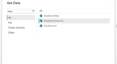

    Instead of using the "Web" connector, try using the "SharePoint Folder" or "SharePoint Online List" connectors in Power BI Desktop. Go to Get Data-> SharePoint Folder. Enter your SharePoint site URL, e.g. https://yourcompany.sharepoint.com/sites/yoursite
    Navigate to the Excel file and select it.
