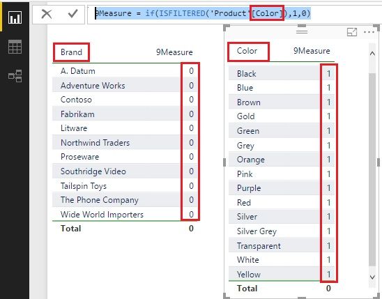

Please refer to this post, maybe it would help. dax-universal-formula-to-calculate-difference-to-previous-period
9Measure = IF ( ISFILTERED ( 'Product'[Color] ), 1, 0 )

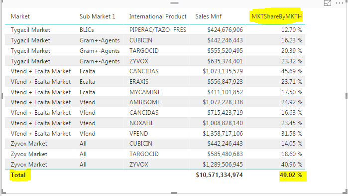

In the screenshot you can see Total showing 49% which is wrong it should be 100%

Hi @mdaamirkhan,
It's a trick of context. The "Total" hasn't have a filter all the time. Try this formula please. (format to percentage)
MKTShareByMKTH = IF ( ISFILTERED ( PFIZER_RADER_REPORTING[International Product] ), SUM ( PFIZER_RADER_REPORTING[Sales Mnf] ) / CALCULATE ( SUM ( PFIZER_RADER_REPORTING[Sales Mnf] ), ALL ( PFIZER_RADER_REPORTING[International Product] ) ), IF ( ISFILTERED ( PFIZER_RADER_REPORTING[Sub Market 1] ), SUM ( PFIZER_RADER_REPORTING[Sales Mnf] ) / CALCULATE ( SUM ( PFIZER_RADER_REPORTING[Sales Mnf] ), ALL ( PFIZER_RADER_REPORTING[Sub Market 1] ) ), IF ( ISFILTERED ( PFIZER_RADER_REPORTING[Market] ), SUM ( PFIZER_RADER_REPORTING[Sales Mnf] ) / CALCULATE ( SUM ( PFIZER_RADER_REPORTING[Sales Mnf] ), ALL ( PFIZER_RADER_REPORTING[Market] ) ), 1 ) ) )

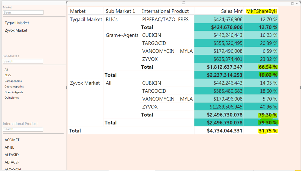

Attributeslicers on the left side in the screenshot but didnt select anything in the fliter or slicer see value showing wrong it should be 100% . I have also prepared the sample data for you link: https://drive.google.com/open?id=0BxreilNC4AvsbzhBR2hvZG5tZVE
Hi @mdaamirkhan,
This is something about context. I worked it out, but it can't be used generally.
test2 = IF ( ISFILTERED ( PFIZER_RADER_REPORTING[International Product] ), SUM ( PFIZER_RADER_REPORTING[Sales Mnf] ) / CALCULATE ( SUM ( PFIZER_RADER_REPORTING[Sales Mnf] ), ALL ( PFIZER_RADER_REPORTING[International Product] ) ), IF ( ISFILTERED ( PFIZER_RADER_REPORTING[Sub Market 1] ), SUM ( PFIZER_RADER_REPORTING[Sales Mnf] ) / CALCULATE ( SUM ( PFIZER_RADER_REPORTING[Sales Mnf] ), ALLEXCEPT ( PFIZER_RADER_REPORTING, PFIZER_RADER_REPORTING[Sub Market 1] ) ), IF ( ISFILTERED ( PFIZER_RADER_REPORTING[Market] ), SUM ( PFIZER_RADER_REPORTING[Sales Mnf] ) / CALCULATE ( SUM ( PFIZER_RADER_REPORTING[Sales Mnf] ), ALLEXCEPT ( PFIZER_RADER_REPORTING, PFIZER_RADER_REPORTING[Market] ) ), 1 ) ) )
Take the first two field as example. The context of "PIPERAC/TAZO FRES" is "International Product", while the context of "Total" is "Sub Market 1". So the formula chooses the wrong "if" clause.
