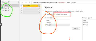

Hello, someone has an idea of how you could add new queries in a faster way, without having to go from one to one... I am loaded the xq sheets I plan to append them but apparently PB does not allow me to append if they are not loaded as new queries. could anyone help me?

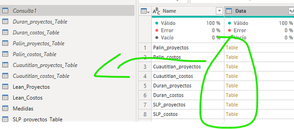

You need to add a step in advanced editor:
Using formula in pq:
CombineTable= Table.Combine(Source[Data])
It involves privacy, so I can only take screenshots step by step. Here is my sample:

What I want is to avoid loading the queries as it has green and then do the red color. my question is if I can append the queries without having to add them (Green color), I want to append them directly, I have many approximate 40 sheets with the same # of columns and I want to append them to use 1 a query.

I would say you are a crazy my friend, this is what I needed.. although I see that the names of the columns were changed to an additional one followed by DATA. Column Name. is there a way to fix this?
I think that should be automatic, because you merge by custom code, It needs to distinguish different columns. If you mind, it needs to be modified manually.

These queries can be added quite fast by right-clicking a "cell" and selecting add as new query or perhaps in this case the best option is to skip this and use Table.Combine(Source[Data]) as a step. This will create an appended table.

Can you show an example? I need each table to be appended one after another so that in the dax model and applications I can use a single data query.
I found a post describing what I meant with table.combine: https://community.powerbi.com/t5/Desktop/Power-Query-Dynamically-Append-from-Table-of-Tables/m-p/960...
I couldn't do it you can show a video doing the procedure?
