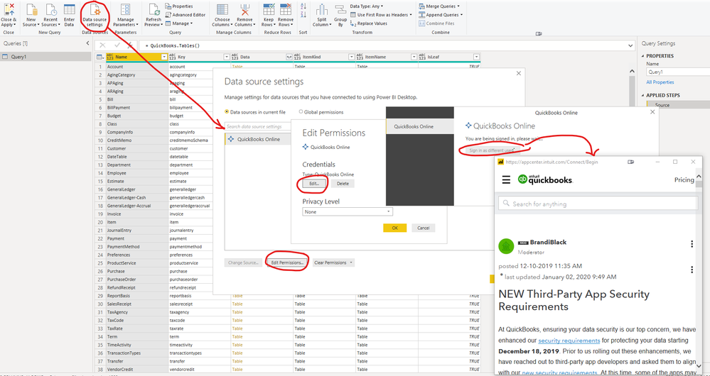

This is awesome, but when I try to add credentials, this is what I get.
After I type in QuickBooks.Tables(), I select Data source Settings, Edit permissions, Edit, Sign in as different user (because I need to access a specific client account). Then, I get this instead of a login screen.
I have the exact same problem, even though I have Full access to QBO of the client.
Any idea why the NEW Third-Party App shows up when we are trying to connect to QBO?
