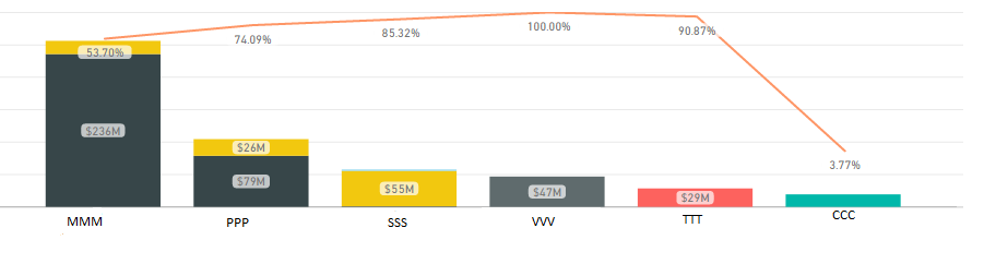

I am trying to create a Pareto Chart which shows the running Total of Spend in percentge as Line.
The Columns are sorted by Total Spend for each category (MM, PPP, SS etc) in Desc order
I used Quick Measure option on Sum("Spend") field to create a "Running Total". When this is added as a Line Value, the data points are appearing sorted by the Category ( notice VVV has 100% and its the 4 bar, ).
The Cumulative of Spend (Running Total) should happened by the Total Spend sorted in Desc order, not by Category Text!
Here is the DAX created by Quick Measure:
Sumof Line Amount running total in Category

Hi @v-haibl-msft & @Phil_Seamark
Thank you for the resposes!
1) Sorting on the line will not working, because its a Pareto Chart, that should Columns sorted by Top Spend. The Line should have Running total for each Bar.
2) Phil, I tried your Formula, its giving similar output. Here is the output:
Ideally, the output shoudl look like this:
