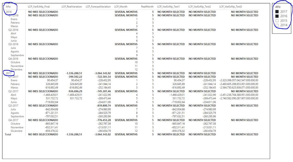

      The forecast uses a formula with data from two tables, one is the same table than the real data and other different table. The table V_Real is not connected with any table in the model because it only recover a month number to determine wich month is currently the real month I have a Calendar table in the model, connected with all the fact tables wich have date fields, and it is the only 'valid' date table in the model. Always the year, months, quarters are taken from this Calendar table.
      My issue occurs only in Power BI Desktop, in Excel it works fine.
      I have more information as you can see in the images bellow. Always I take the year from the Calendar table. If I show this same year in the matrix, the results are wrong:
      If I remove the year from the matrix, the result is right:
      Both matrix and slicer takes the year from the Calendar table.
      Thank you.
