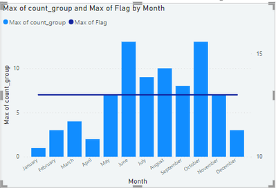

    Hi  Anonymous ,
    1. Create calculated column.
    count_group =
    COUNTX(FILTER(ALL('Table'),MONTH('Table'[Date])=MONTH(EARLIER('Table'[Date]))),[Id])
    Flag =
    IF(
        'Table'[moving]="no",0,
    MAXX(ALL('Table'),[count_group]))
    2. Placed in Visual, both set to Max.
    3. Result:
    If you need pbix, please click here.
    Problem when visualizing in line and clustered column chart.pbix
    Liu Yang
      Hi Anonymous
      I followed the steps but I didn't get the same result as you!
      Let me know if there is any problem
      thank you,
      Salim
