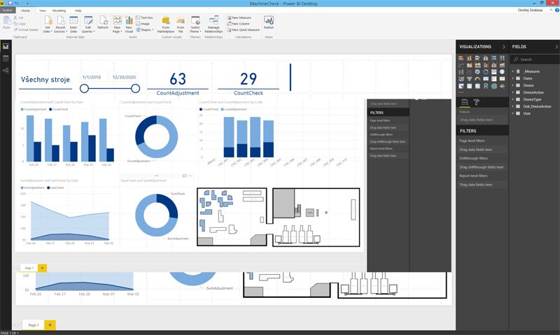

since the february update I am experiencing a weird behavior - when I drag my Power BI Desktop window from my laptop screen to my external screen (1920x1200), the canvas starts to "repicture" itself as the cursor moves around, making it impossible to select visuals or work within the application at all.
Has anyone been experiencing the same issue? Any ideas on how to fix that?
Thanks a lot, Ondřej.
