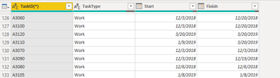

This is my data table, I want to convert the table from start and finish date, into vertical dates.
I am not sure if the technical term to do this is called Pivoting.
Example:
Line 126, Task ID A3060 ,, Start date: 12/3/2018 ,, Finish date: 12/20/2018
Want to change that into:
A3060 12/3/2018
A3060 12/4/2018
A3060 12/5/2018
...until
A3060 12/20/2018
Also Most of the Task ID have Start and Finish dates, and some have only Start date or Finish date, not sure how that would affect

@amitchandak , Thank for the help.. The Dax you shared helped me in another project
@amitchandak , Thanks I took a dive in to the file you had shared with me, it has interesting result
can we do this to the source table itself,
Taking example of the data table you have, can we change the dates into list format between these two dates..
Change the above table itself to List type based on dates, For first value Start : 19-Mar-20, End: 1-Apr-20
ID | Date
1 19-Mar-20
1 20-Mar-20
1 21-Mar-20
1 1-Apr-20
