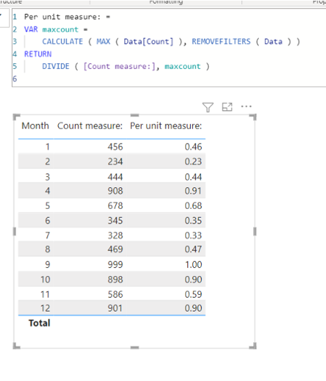

I hope you can get an idea on how to create a measure from the below picture and the attached pbix file.
Per unit measure: =
VAR maxcount =
    CALCULATE ( MAX ( Data[Count] ), REMOVEFILTERS ( Data ) )
    DIVIDE ( [Count measure:], maxcount )
If this post helps, then please consider accepting it as the solution to help other members find it faster, and give a big thumbs up.
