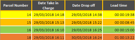

I must calculate the Leadtime between two movements "Take in charge" - "Drop off" with the same parcel, for example:
But I have some difficulties:
- I must keep only the parcels with these two movements
- I can't calculate the Leadtime with "datediff" because the dates are not on the same line.
I would like this result on Power BI:
How should I proceed to do that?

Thank you very much @v-piga-msft for your answer. It works well! Smiley Very Happy
