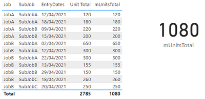

The result looks like this:
For more details, you can refer the attached pbix file.
