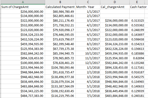

Hi guys,
I'm having a bit of a dilemma with generating a Calculated Column in DAX, the goal is to calculate Cal_charge+Amt column from the Excel table above. As you can see, the data on that column is exactly the same numbers as Sum of chargeAmt except that it's offset by 2 months behind. I have no idea where to begin to be able to generate that new column and make the first 2 rows blank like that. I need that column in order to generate Cash Factor. I'm new to the Power BI and DAX world so I would appreciate the help.
Try this calculated column
Cal_charge+Amt =
VAR temp =
TOPN (
2,
FILTER ( Table3, [Month-Year] < EARLIER ( [Month-Year] ) ),
[Month-Year], DESC
VAR temp1 =
TOPN ( 1, temp, [Month-Year], ASC )
IF ( COUNTROWS ( temp ) = 2, MINX ( temp1, [Sum of ChargeAmt] ) )
When I use it with a sample table it works
Please see Power Pivot model in attached Excel Workbook
Hi @ccueto36,
Based on my test, I have tried what Zubair suggested, it could work on my side, and you could also refer to my step:
Sample data:
Create a calculated column:
Column 2 = var a=MONTH('Table3'[Month-Year])-2
return CALCULATE(SUM(Table3[Sum of ChargeAmt]),FILTER('Table3',MONTH('Table3'[Month-Year])=a))Result(Column1 is the Zubair's function):
You could also download the pbix to have a view, if it still could not work, could you please share the pbix if possible?
https://www.dropbox.com/s/jjdh69fw2ipjbr4/Offsetting%20Calculated%20Column%20Rows.pbix?dl=0
Cal_charge+Amt =
VAR temp =
TOPN (
2,
[Month-Year], DESC
VAR temp1 =
Thank you for the sample, I can also make it work just fine in Excel Power Pivot but the same does not seem to work in Power BI Calculated Column, keeps returning blank column 😕
Hi @ccueto36,
Sample data:
Daniel He
