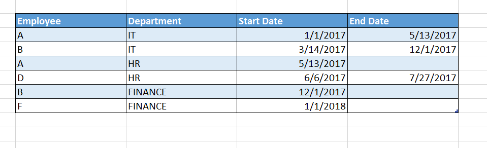

I'm trying to figure out a formula that calculate the number of employee for each day between two dates. My table looks something like this:
I have a calendar table and I need know for each day how many people we have in IT, HR, Fianance, ...etc.
I very much appreacite your help.
