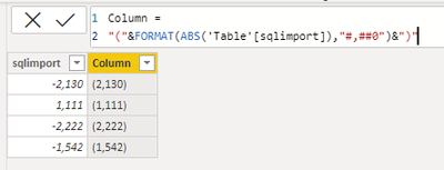

    Hi  aishak12  ,
    According to your description, I create some data:
    1. Create calculated column.
    Column =
    "("&FORMAT(ABS('Table'[sqlimport]),"#,##0")&")"
    2. Result:
