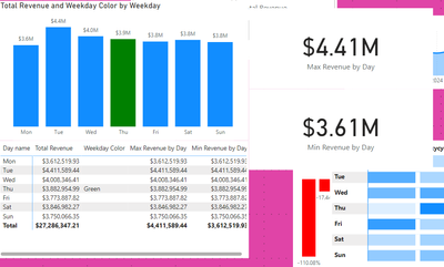

I am trying to color the highest and lowest values by revenue in a chart. I've created measures for max values, min values and then measure for color.
Individually max and min values are working correctly, however when I use them in a color measure, they are giving wrong results.
Measure for Revenue
Total Revenue = SUMX(FactTable,
        RELATED(DrugLookup[UnitSalesPrice])*FactTable[UnitsSold])
Measure for Max
Max Revenue by Day =
VAR _max = MAXX(
        SUMMARIZE(
            DateTable,
            DateTable[Day name],
            "TotalRevenue", [Total Revenue]
        [TotalRevenue])
_max
Measure For Min
Min Revenue by Day =
VAR _Min =
    MINX(
        SUMMARIZE(
            DateTable,
        [TotalRevenue]
_Min
Measure for Color
Weekday Color =
VAR _max = [Max Revenue by Day]
VAR _min = [Min Revenue by Day]
SWITCH(
    TRUE(),
    [Total Revenue] = _max, "Green",
    [Total Revenue] = _min, "Red"
Ju
I am attaching Screenshot for results as well.

Hi, Thanks for Response.
I am sharing drive link of the file. Go to Calender Sheet, in the bar chart I want to highlight highest and lowest. for 2024 it's working but not for other years. I dont know whats the reason.
Thanks.

Hi, Thanks for response.
I found the reason, as soon as I sort the 'day name column' by column 'daynumber', this anomaly appears.
If you find the solution, please let me know. Thanks
Even in your screenshot the sorting is out of order.
Hi @Zeshansaif
Sorry, i didn't check the order of the days.
You can update the formula to :
Weekday Color =
if(
    CALCULATE(MAXX(
        SUMMARIZE(FactTable,DateTable[Day Name],DateTable[Day of Week],"total revenue" ,[Total Revenue]),[total revenue]),ALLSELECTED(DateTable[Day Name],DateTable[Day of Week]))=[Total Revenue],"Green",
        if(
    CALCULATE(MINX(
        SUMMARIZE(FactTable,DateTable[Day Name],DateTable[Day of Week],"total revenue" ,[Total Revenue]),[total revenue]),ALLSELECTED(DateTable))=[Total Revenue],"Red","blue")
It will work with a sorted day too :
The updated pbix is attached
