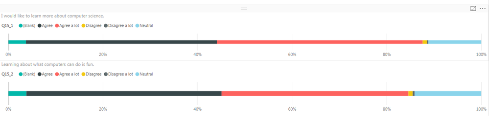

Multiple Stacked Bar Charts
  Is something like this possible? I have a bunch of questions of "Do you agree with X" that I need to be able to display side by side and the following is the best I can come up with currentl...

    travbum As I suspected you have to Unpivot the Data.
    With the sample you posted => Edit Queries => select the User ID column => Unpivot Other => Close & Apply
    Then set up as my original answer!
