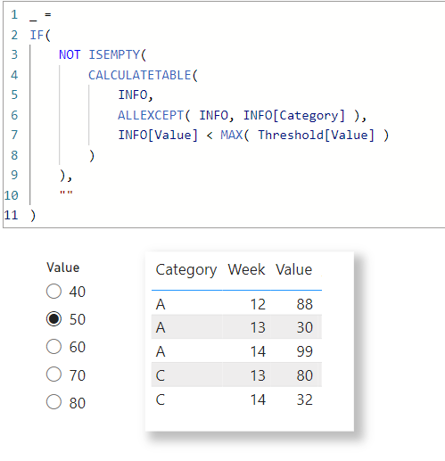

- Anonymous3 years ago
Hi honkiedonkie ,
Please refer to my pbix file.
Community Support Team _ RongtieIf this post helps, then please consider Accept it as the solution to help the other members find it more quickly.

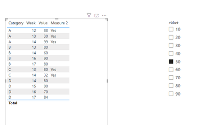

Hi honkiedonkie ,
Please have a try.
Create 2 measures.
Measure = VAR _1 = SELECTEDVALUE ( 'Table (2)'[value] ) VAR _2 = IF ( MAX ( 'Table'[Value] ) <= _1, "Yes", BLANK () ) RETURN _2Measure2 = MAXX ( FILTER ( ALL ( 'Table' ), 'Table'[Category] = SELECTEDVALUE ( 'Table'[Category] ) ), [Measure] )How to Get Your Question Answered Quickly
If it does not help, please provide more details with your desired output and pbix file without privacy information (or some sample data) .
- honkiedonkieNew Member
This also works, thank you!

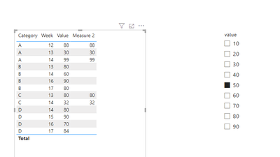

However I was wondering - if I want to insert the corresponding value into Measure 2 rather than 'Yes', how could I go about it? Eg. for the C rows, it will display 80 and 32 respectively instead of 'Yes'. MAXX will give me the max of all the values corresponding to the same category and I know that that is expected behaviour. Could you advise me on how to go about doing this? Thank you!
- AnonymousNot applicable
Hi honkiedonkie ,
Please try to change the measure2.

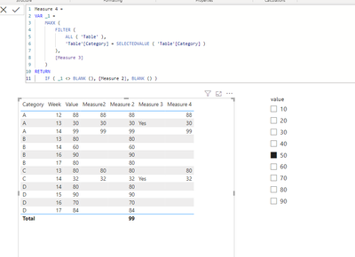

Measure2 = VAR _1 = MAXX ( FILTER ( ALL ( 'Table' ), 'Table'[Category] = SELECTEDVALUE ( 'Table'[Category] ) ), [Measure] ) RETURN IF ( _1 <> BLANK (), MAX ( 'Table'[Value] ), BLANK () )How to Get Your Question Answered Quickly
