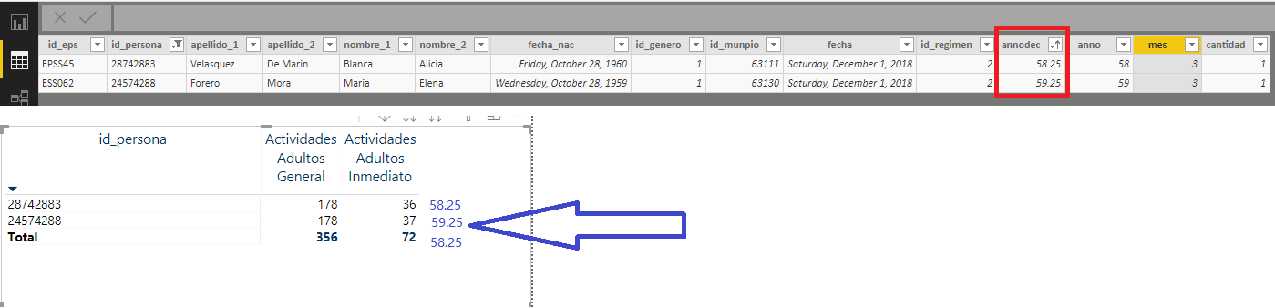

Hi!
I have a very disgusting issue here:
First, the measure simply doesn't do the correct sum.
The strange thing is that measure already uses SUMX. I tried several things without success. Then, the problem got worse. The highlighted measure when is under a low-level filter shows the data. But when the measure is without any filters the data simply disappear.
The goal of that measure is to show the number of filtered movements. The first measure is the total of movements. The wrong one is the filtered movements.
Well, that's all. I know the importance of the sample of data so my little file can be found here:
https://1drv.ms/u/s!AtTnrgPUQzQCgrN2hHAzvVKnJqBt9Q
Hope you guys can help me.
Thanks.

Hi @AlejandroPCar,
This could be a context issue. I'm afraid you can't get your desired results. What would you like to get with them?
Let's have a look at the first issue.
Actividades Adultos Inmediato =
    VAR adult =
            SUMX(
                VALUES(Adult_Quindio[id_persona]),
                CALCULATE(
                    SUM(Jerarquia_Adult[cantidad]),
                    FILTER(
                        Jerarquia_Adult,
                        AND(
			// What do you think the MIN(Adult_Quindio[annodec]) should be?
			// It's two different values in the rows while it's a single value in the Total.
                            MIN(Adult_Quindio[annodec]) >= Jerarquia_Adult[edadinicial],
                            MIN(Adult_Quindio[annodec]) < Jerarquia_Adult[edadfinal]
    adult
Measure-does-not-total-and-disappears-values
Actually, the result 72 is 36 * 2. Why? The context of MIN(Adult_Quindio[annodec]) is from VALUES(Adult_Quindio[id_persona]) that is a row context. MIN ignores the row context. So it's 58.25 in the Total and there are two pieces.
You can adjust your formula according to the explanation above. Maybe you can post the idea that you are going to achieve.

Amazing. Can you explain the reasson of put MIN in a CALCULATE?
Hi @AlejandroPCar,
Usually, calculate-function-dax is used to alter the current context. It also can convert a Row context to the Filter context in which the MIN can evaluate row by row.
