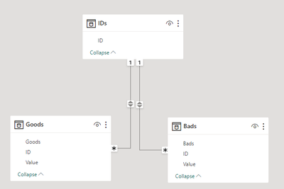

Here's  a version that works but at a high cost - an atrocious data model
see attached.
see attached.
MyOx
Thanks you. That's what I wanted (I though it was simplier to do though 😅)
