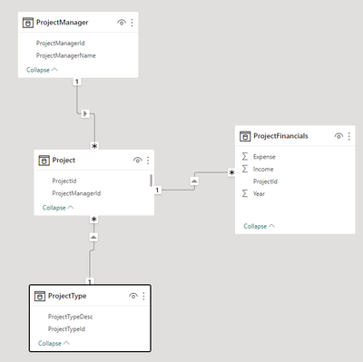

I have a sample data model as follows:
I need to use a matrix to display the project information, grouped by year.  I also want to have alternating row colours, but for some reason I cannot find an option to extend the row colour across all columns (as follows).
I know I can achieve this with a table, but that doesn't give me the option to group by year.
