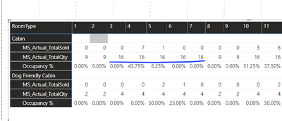

- mohsenask5 years ago
Helper II
amitchandak - Thanks for your reply
Sorry tried to paste the table here but it gives me some weird HTML error. IT says removed the invalid HTML and try submitting again but doesnt work.
Tried uploading csv or xls - didnt allow.
The below extract from the data table shows totalQty as max 9
in a simple table visual the rows show correct TotalQty as 9
However in the matrix its shows TotalQty as 16 for certain dates
ā
Helper II
amitchandak - any help???
Ive attached a test pbix file - https://www.dropbox.com/s/59c5luuqbby2wxg/BG_MIS_test.pbix?dl=0
