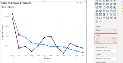

 I have a simple line chart with circle markers for each month.  Each marker for each month is color formatted based on criteria.  Currently the chart has just one line, and this works fine.  However, when I add a legend to the chart so that I can show multiple lines, all my color formatting of the markers goes away.  Is there any way to have a multi-line chart with color formatted markers together with a legend to distinguish each line?  Thank you

Hi @ldwf ,
Please put the fields in the y-axi, not in the legend.

Thanks but unfortunately that doesn't help.  Your chart is bringing a metric to the y-axis.  In my case, I want to show a dimension.  I want to show a different line for each value in a dimension and I want the markers to be color/conditionally formatted.  Thanks
Hi @ldwf ,
Based on the information you provided, I can't tell exactly what the problem is? Could you provide some screenshots (hiding sensitive information) to help us better solve your problem.

@ldwf , conditional formatting is not supported with legend or when you use more than one value/measure
