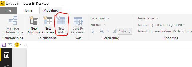

SUMMARIZECOLUMNSFunction returns a summary table over a set of groups. You need create a new table when you use SUMMARIZECOLUMNS() function. But the New Table is unable when you connect database using Direct Query. So the function is also not supported.
