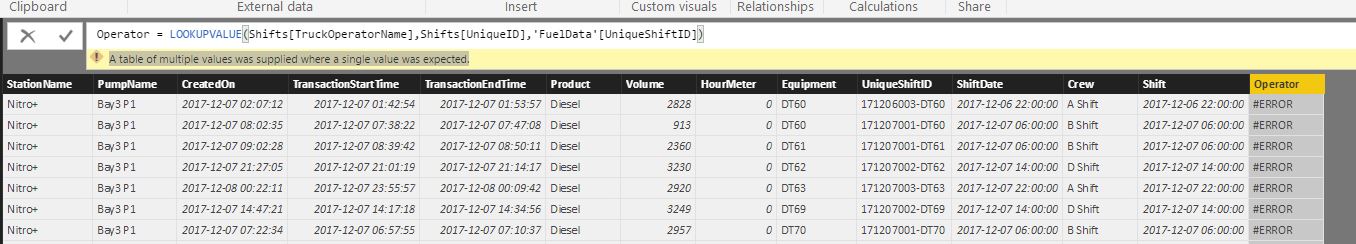

I'm trying to use the LOOKUPVALUE function to lookup values from Table 2 in Table 1.  It is supposed to be a simple venture but for some reason one of the columns won't work.  I get the following error:
"A table of multiple values was supplied where a single value was expected"

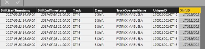

Column UniqueShiftID in Table1 and UniqueID in Table2 are used for referencing the rows.
In Table1, columns Crew and Shift work with the LOOKUPVALUE function.  Taking the exact same code, and referncing TruckOperatorName in Table2, gives the error.
Any idea why this would happen?
TABLE 1 (FuelData)
TABLE 2 (Shifts)

Hi @fjmocke
Could you please Try this alternative
Operator=
    FIRSTNONBLANK ( Shifts[TruckOperatorName], 1 ),
    FILTER ( ALL ( Shifts ), Shifts[UniqueID] = FuelData[UniqueShiftID] )

Helper II
Thank you for the suggestion to use the FIRSTNONBLANK! I was trying to use the LOOKUP as well and not having any luck getting the results that I was looking for. Relationship between Table1 and Table2 are Many to Many. I used the FIRSTNONBLANK with multiple filters to narrow my results further.
