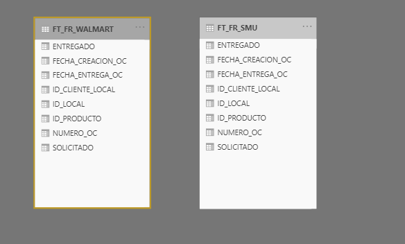

The problem is that the two tables are still separated in the model...
How can I join them to be the same table?
