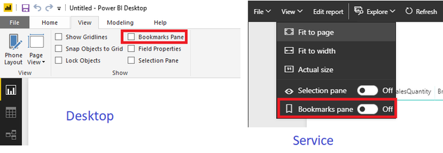

Hi @Jay2077,
Please refer to the snapshot. If you want to use it in the Service, you need to add at least one bookmark in the Desktop then publish.
