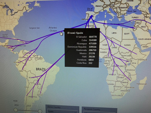

I would like comma separated values in a pop-up box that shows up when you hover over a line on a flow map.

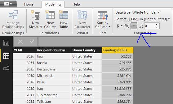

On the data tab, I clicked on the thousands separator and within the spreadsheet, all the values are comma separated
However, on the report tab, when I hover over a flow line, the values in the pop-up box are not separated.

    What pop-up box do you mean? Do you mean the tooltip like below?
    Could you show me the screenshots to specify your scenario, so that we can help further investigate on it?

      On my data tab, I've formatted all of the funding in USD to be comma separated values.
      Data tab
      But, on the visual itself. The comma formatted values do not show up in the Tool Tip that pops up when hovering over the lines on the flow map.
      Any advice you can give on how to fix this would be much appreciated. Many thanks!

    I have this problem also... there does not appear to be a way to control the format of data shown in the tooltip when hovering over the line or the destination...
