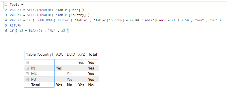

Request was to have a table with country on rows and on columns users. Then he wanted a value of 'Yes' when the combination exists and 'No' when it doesn't. The solution for him was with a twist as 'blank' was sufficient as a 'No'. Just like below:
But I wanted more. I wanted the 'No' on the blank values. So I continued. So I followed up with:

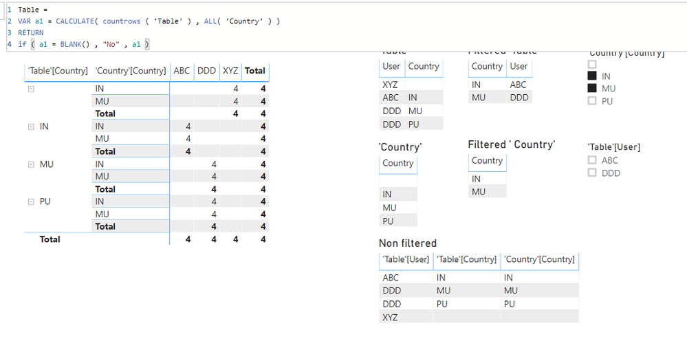

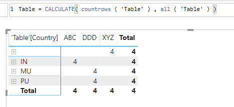

So to screw with my brain even further, first a basic countrows with a filter on 'Country'[Country]:
And now changing the context to an all statement for the countrows:
So basically I have only 1 question. What do I need to do to make sure everywhere in this matrix with this source data the blank values are replaced with "No".

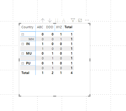

When reading through your solution, I doubted the results but tried anyway. The problem I saw was that you don't actually change the context of the matrix. If you would remove the 'Table'[Country] category in my own printscreens, you would see this return the same return values as your solution.
Your solution with an extra filter on 'Table'[State] :
As you can see, this is the same behavior as in my initial post. I'm afraid this is not the solution for my issue. If you can be bothered with giving it another shot, that would be great :).
