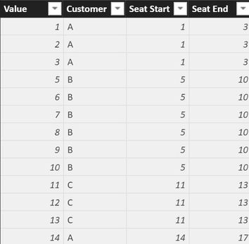

      I was trying to create a table and fill down the missing values.
      Presently I have done it in two steps.
      1. Create the table.
      DAX Table =
      VAR JointTable = NATURALLEFTOUTERJOIN(SeatNumbers,SeatBookings)
      JointTable
      2. Then fill down the missing value in a new column.
      Customer Fill Down =
      VAR LstNoBlankCustomer =
              LASTNONBLANK ( 'DAX Table'[SeatNum], 1 ),
              FILTER (
                  ALL ( 'DAX Table' ),
                  'DAX Table'[SeatNum] <= EARLIER ( 'DAX Table'[SeatNum] )
                      && NOT ( ISBLANK ( 'DAX Table'[Customer] ) )
              MAX ( 'DAX Table'[Customer] ),
              FILTER ( ALL ( 'DAX Table' ), 'DAX Table'[SeatNum] = LstNoBlankCustomer )
      Repeat the new column step for Seat Start and Seat End.
      So the final table is :
      What I was trying to achieve is instead of creating the virtual table and then adding columns to it do it in a single dax create table step.

        Hi again anandav
        Thanks for the additional info.
        From what you've provided, could I suggest a different approach, as doing the fill-down in DAX is possible but a little awkward.
        I'm making an assumption that you are really interested in SeatNum and Booked Customer from your screenshot below. If so, I would propose this:
        DAX Table =
        VAR SeatNumbersPlusBookings =
            GENERATEALL (
                SeatNumbers,
                GENERATE (
                    SeatBookings,
                    INTERSECT (
                        GENERATESERIES ( SeatBookings[Seat Start], SeatBookings[Seat End] ),
                        { SeatNumbers[SeatNum] }
        VAR FinalTable =
            SELECTCOLUMNS (
                SeatNumbersPlusBookings,
                "SeatNum", SeatNumbers[SeatNum],
                "Booked Customer",
                VAR CurrentCustomer = SeatBookings[Customer]
                    IF ( ISBLANK ( CurrentCustomer ), "Empty", CurrentCustomer )
            FinalTable
        I'm using GENERATEALL to do the join rather than NATURALLEFTOUTERJOIN since your physical SeatBookings table don't have all the required values (since it contains Seat Start and Seat End), and GENERATE to convert the start/end values to a range.
        You could of course include additional columns on top of the two output by the above.
        Owen
