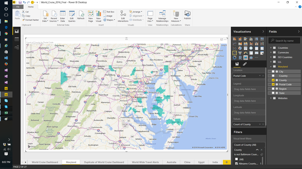

Thank you, this helped me to figure out why my maps wouldn't work! My maps are now working and I'm using post code with Filled Map and Long/Lat with the globe Map.
Thanks for the tips, Greggyb. In regards to county, I had to use "Howard County, MD" [County, State] or my data was off.
Also, do you know why it bubbles instead of filling in the county borders? EDIT: I got it. I used the regular MAP but "filled" is the border one.
Mapping by County
Filled Map by Zipcode
I couldn't pull up any city in Howard or Carroll County, Maryland though...weird! I'll open tickets with Bing Maps.

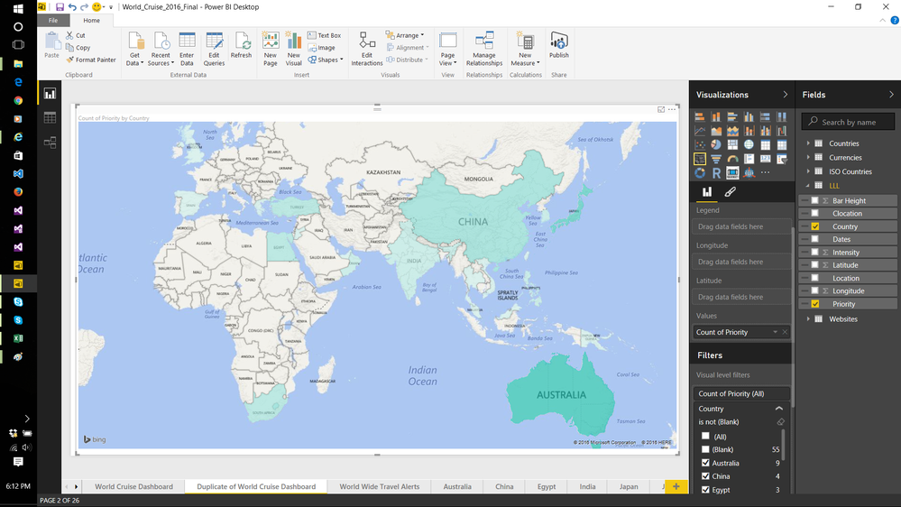

Ukraine I got done. I could do "city" filled map and a regular map. I put in the administrative centres and color coded the oblasts!
Capitals with color coded Oblasts
Filled Map by Cities
This is the result with just the original "Map"
Combined Locations Colored
Individually colored

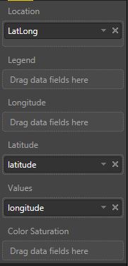

I was able to get it working by:
1. Using a concatenated lat/long in the "Location" field (eg. "<latitude>,<longitude>", no quotes though)
2. Putting Latitude into the "Latitude" field
3. Putting Longitude into the "Values" field, NOT the Longitude field
4. Leaving the "Longitude" field empty
I don't know why it worked, but it did.
