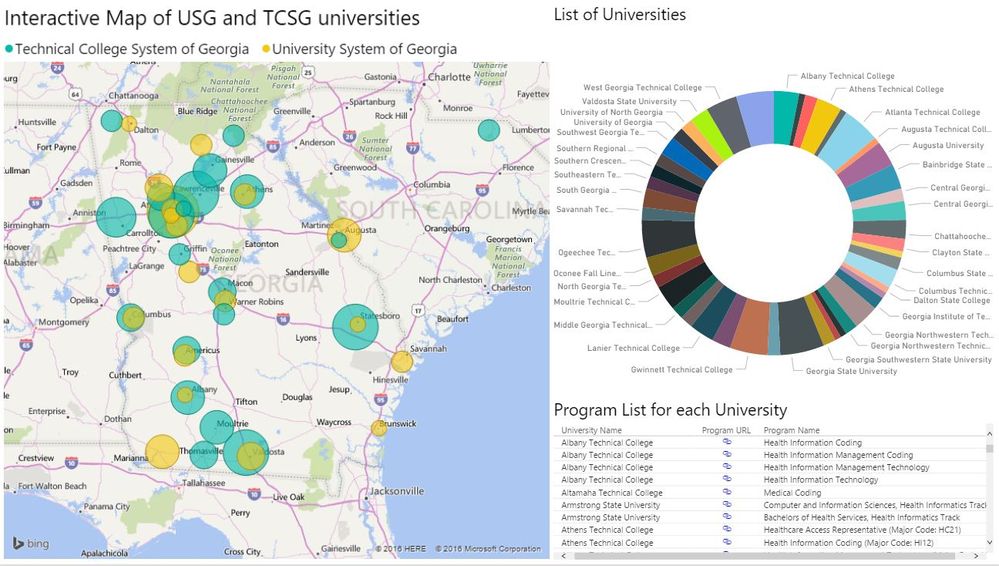

I am working on a report that consists of a map, donut chart and table. The map and donut chart are interacting with each other but the table is not. Is there a way that I can make the table interact with the donut chart and also, with the map?

Yes. I have used the same data sheet for the map, donut chart as well as the table. It's just the filters that are different. What I am trying to achieve is if I click on the university name or program name in the table, the donut chart and map get updated accordingly. So, for example if I click on Master of Science in Information Systems at Georgia State University, the donut chart highlights Georgia State University and so does the map. Please find attached a screenshot for your reference.

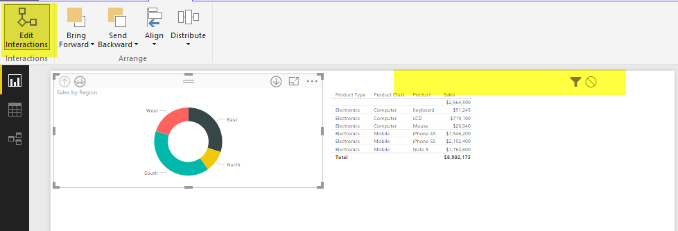

Please verify your ineractions between table and donut chart. Please refer to below image.
