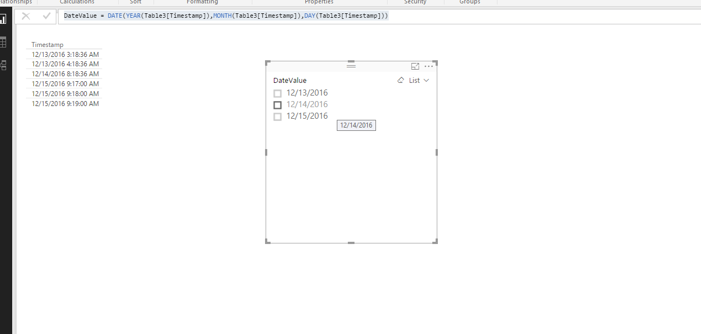

Hi @Anonymous,
Create a new column using the following formula, then change the data type of the new column to Date under Modeling ribbon and create a slicer using the new column. There is an example for your reference.
DateValue = DATE(YEAR(Table3[Timestamp]),MONTH(Table3[Timestamp]),DAY(Table3[Timestamp]))

Hi @Anonymous,
You can create a new column using the following formula, then change the data type of the new column to Date under Modeling ribbon and create a slicer using the new column. There is an example for your reference.
DateColumn = TableName[Timestampcolumn]

Hi @Anonymous,
