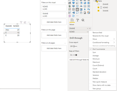

Hi @vikrammankar ,
I suggest you to create a table visual by "Don't summarize" function in [NOWD] column in Value Field.
My Sample:
Result is as below.
Or you can create a calculated table with distinct (NOWD and SNAME).
Distinct Table =
SUMMARIZE('Table','Table'[SNAME],'Table'[NOWD])
Result is as below.
