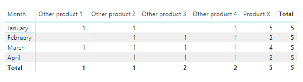

I create a sample you can reference to modify yours.
  1. These are my two tables.
  1. Create a measure and add it into a matrix.
Measure = CALCULATE(DISTINCTCOUNT(Table2[Users]),ALLEXCEPT(Table2,Table2[Date].[Month],Table2[Products]))
