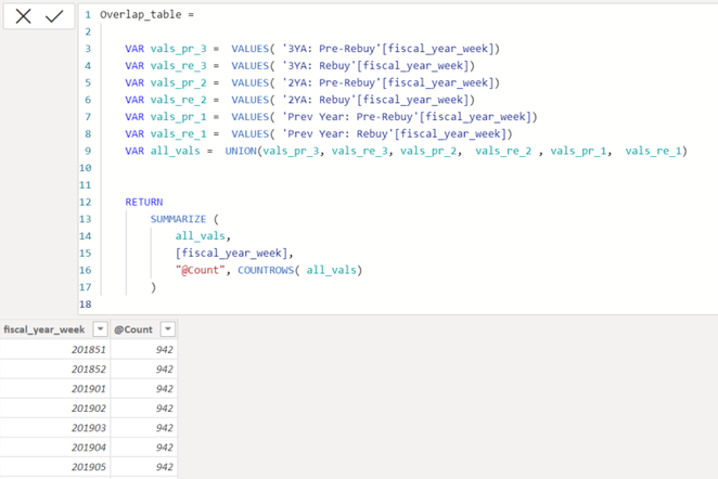

Here I create variables for each calendars list of fiscal year week values.

To clarify, when I use the whole code you had sent over, it says there's lots of duplicates.
So, I used just the highlighted part of the code you sent in a table to see what it was doing, and like you're mentioning, this inner part of the function is counting all the rows instead of counting the dupilcates.
So, by the time it passes this data to the outter SUMX function, it makes sense that there are lots of duplicates, as it appears to be counting all the rows in the table. Does that make sense?

I think it's getting closer, thank you - but not quite there yet.
If I just look at the inner (Summarize) Part of the function, and put it in a table temporarily (later I'll put it in a measure), to see what's going on, the Counts seem much higher, as there should only by 6 distinct counts of each fiscal_year_week, instead of the 942 it's reporting.
