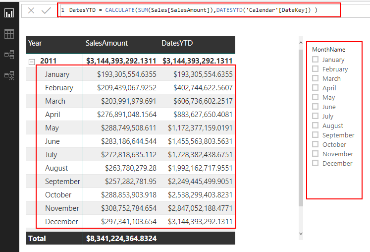

HI @Shelley,
You can modify your DAX expression as per below screenshot.
You can select any month from Slicer, the table visual will show total till that month only.
Or, may be you are looking for DATESMTD function. You can use
DatesMTD = CALCULATE(SUM(Sales[SalesAmount]),DATESMTD('Calendar'[DateKey]) )
Thanks,
Amit
Thank you for the help, but I don't see how the formula you propose is different than mine? Also, it does the same as mine, it calculates YTD THRU the month selected, so if I have Dec selected, it calcs Oct, Nov and Dec; however, if Dec is selected, I only want Dec total to show. Likewise, if I have Dec and Jan selected, I want to see the two months added together - I don't want the full year to date value. Is there any way to do this?
