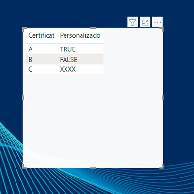

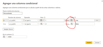

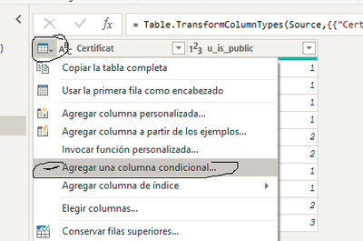

  1. A simple solution would be to add a conditional column.Boricuanet_0-1654789512397.png
  3. Keeping the text-like values.
    I assume that the data already has them of Boolean type. So you can do the same for Boolean values, create a copy of the column, text-like formatting.
Best regards.
