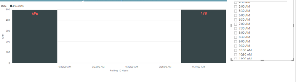

This is my second go at this Time Range Slicer (previous post) thing- I created a date table, shift table and and hour / half hour table using the suggestions posted from my earlier attempt.
Starting with the hours (because I need to create a time filter), I created the relationships necessary - however when I try to filter by time, it doesn't work properly. I've also tried the Advanced Time Slicer visual and it works well, but I'm not sure it's developed enough for what we need it to do. Here are some screen shots...
Trying to use time filters:
Without Time Filters - DataWithout Time Filters - DataWithout Time Filters - NO DataWithout Time Filters - NO DataAdvanced Time Slicer Attempt (not enough detail)Advanced Time Slicer Attempt (not enough detail)
I need to be able to filter the data by time (up to the half hour). I'm willing to revamp my approach because I HAVE to have this in less than a few weeks. It seems so simple, but I can get it to work the way I need it to. ANY help will be greatly appreciated!!!!

OK,  I took a stab at it - but now it's not filtering at all. The relationship was created without any errors - not sure what's causing the hiccup now.
Data with KeyData with KeyTime with KeyTime with Key

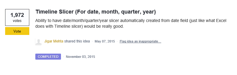

@AlexGorev why does it say completed? Can't Vote?
My bad, this was marked completed when Time Slicer custom visual was introduced. Link below points to the idea to have better native experience...
https://ideas.powerbi.com/forums/265200-power-bi-ideas/suggestions/13397166-better-date-range-filter...
Thanks,
Alex.
