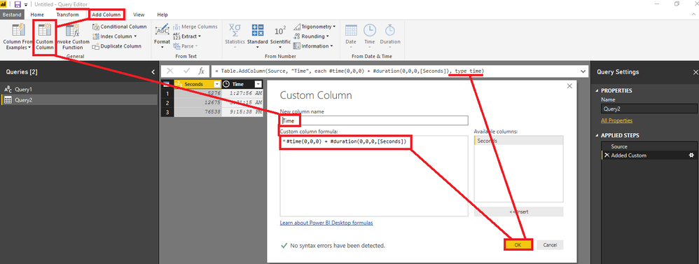

In the Query Editor,
open your query,
go to tab "Add Column"
choose "Custom Column"
enter column name and formula
choose OK
adjust the code by adding ", type time".

If a Power Query solution is also OK:
Source = #table(type table[Seconds = Int64.Type],{{5276}, {12675}, {76538}}),
#"Added Custom" = Table.AddColumn(Source, "Time", each #time(0,0,0) + #duration(0,0,0,[Seconds]), type time)
#"Added Custom"
open your query,
choose OK
